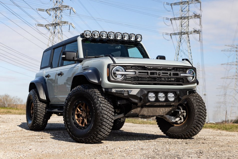

@Spiderwolf look for 17x9 with 0 offset, or somewhere close to that. You shouldn't have any problems at all if you are keeping the 37" factory tire. We have done several with the Vorsteiner Offroad wheel with both 37s and 39s and they don't rub with stock suspension (on the street anyway). If you do hard offroading the 39" will likely rub. The 37 should be fine.
17x9, +0 with 39s on this one
