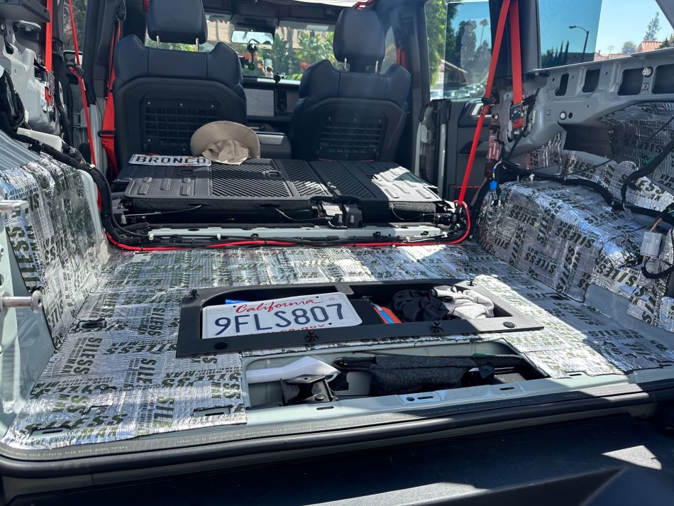

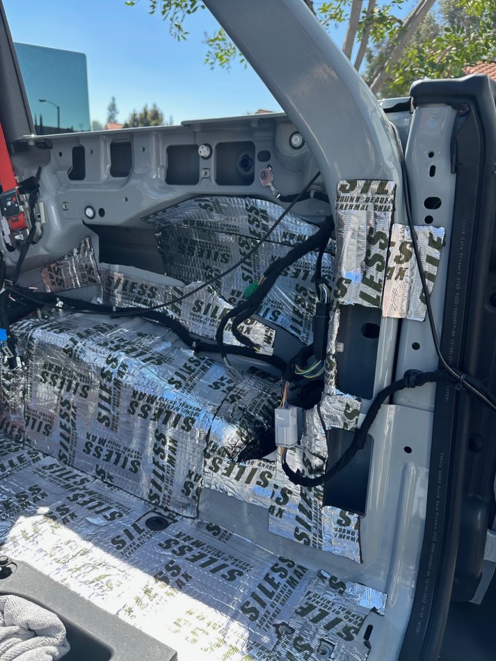

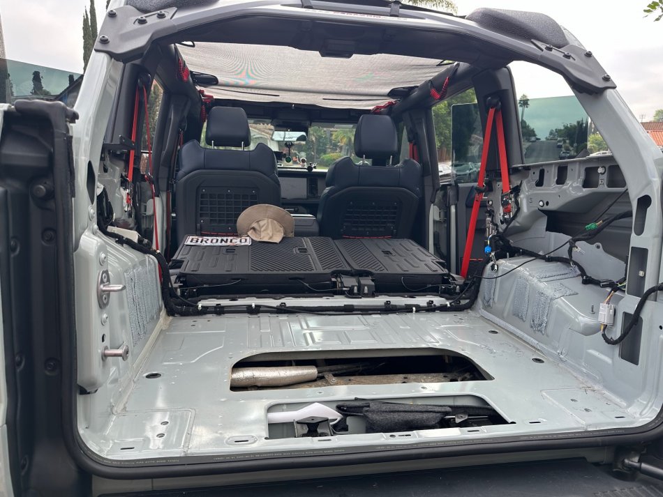

My assessment of the stock B&O was a little different. Top on - no highs, ok mids and ok low but the rattling drove me nuts. Top off - everything bad, especially the rattling. I thought about adding a 12" on the tail gate and call it a day but the more I go through the forums and Youtube, the more I slipped down the car audio rabbit hole and ended up replacing all speakers, adding a MoBrige plug n play amp and doing the Kicker 8" conversion on the stock sub box. I'll be adding the 12" Stinger next.
From what I'm learning on the forums, just replacing the speakers doesn't make a huge difference and probably not worth it. This is due to the limitation of the B&O amp. Replacing the B&O sub with Kicker or any other variant is a better time and money investment. This is all depending on how much of a bass head you are though. Obviously wasn't enough for me...
On the sound deadening, I read from some posts that it didn't make a big difference but my experience is the opposite. I took the opportunity to put Siless, Kilmat, Tesa tape, foam, etc. on everything and to me, it made a huge difference. I'm probably at 99% rattle free at high volume right now. Just couple pics for reference but I'll be happy to answer any specific question with my experience
if I didn't answers your question.

1) Yes, the stock subwoofer was replaced with a Kicker sub. I bought it like that since I wanted to sell my B&O system complete with the box and sub (btw - it's still for sale if you know anyone interested). Picture below. Although I didn't do the conversion, it didn't seem hard to do with numerous forum instructions and videos out there. Here's instruction and video:
2) I had a rattle too and I suspect this was my problem (link below) because when I took everything apart, there's marks where the sub boxes was hitting the panel (pic below and circled, although hard to see in pic). Sounds like a common issue and I would start here. This will take maybe 5 mins and I should have done it when I bought the truck instead of waiting months later....Plus, it's fun read as OP is witty -
If you wanted just more bass, and don't mind not putting another accessory on the on the tailgate, then I recommend just adding a box with a 10/12" sub (such as a Stinger) on the tailgate and power it with another small amp. I believe Plug N Play sells a harness for this now so this should be a relatively "small" project. I probably would have been happy with this set up (and fixing the rattle) if I didn't come across the nice complete set up that another member was selling at a great price. That's how I went down this slippery rabbit hole but I'm glad I did because now, I have crisp high and strong bass and just better audio quality altogether. The only regret is I have to take out my fold down table but I probably won't use that for more than couple times a year versus enjoying the bass every time I drive.
I'm also glad I did because I spent weeks reading everything on line and it seems like a big project tearing everything apart and putting it back together but honestly, it wasn't. I spent the weekend (probably 10 hours total between the two day) replacing all the speakers, replacing the two rear pods to 6/5" speakers, sound deadening, etc. and it was kind of therapeutic for me. I actually enjoyed it and I'll do it again in a heart beat getting my mind off my high-pressure office job.

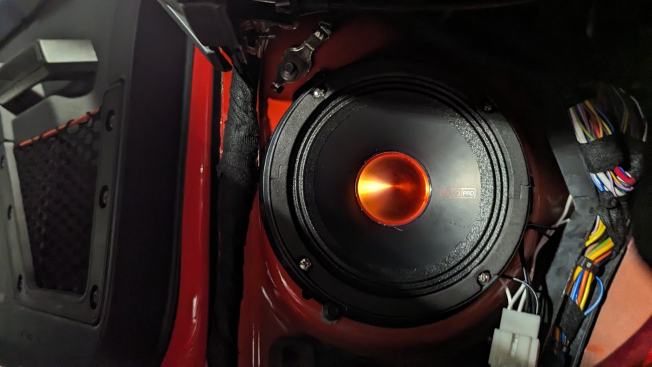

I've replaced all my B&O speakers and upgraded my sub with an amp. It is sooo much better than what it was and I'm probably all in $1100. I went with Infinity Reference 407f speakers in all 3 dash locations and the rollbar pods. Memphis MJP6 woofers in the kickpanels and then a Kicker Comp R 8" sub - Dual Voice Coil 4 Ohm mated to a Kicker Key 500.1 wired in parallel to take it to a 2 Ohm load 300watts also used the remote volume knob for the sub. It is without question a better sounding system with enough thump that I'm sure during top off season will be great. Sorry about the Infinity's missing from the pics - was able to install them so quickly and easily I didn't even think about pics. And I did add some polyfill to all of the speaker enclosures.
The fact that the Infinity and Memphis have such high efficiency ratings allows them to be better even using just the B&O amp for power. The sub would not likely be as useful a change without the amp.
