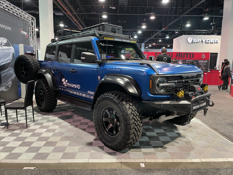

This is the BRaptor with the ADD RockFighter front winch bumper. It's a good option for those wanting a winch. I'm pretty sure the roof rack on this blocks you from removing the roof panels, but I'm not 100% sure.

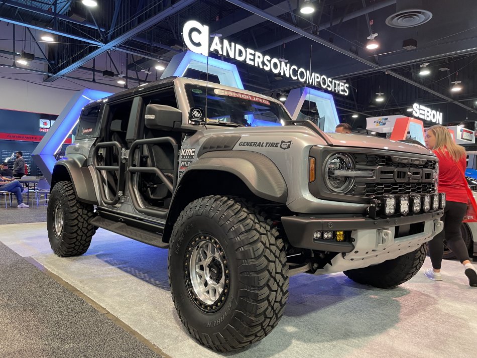

This BRaptor had the full assortment of Anderson Composites carbon fiber parts. Hard top, doors, fenders, hood scoop, and spare tire overlay. This has the factory front bumper on it, and showcases some Baja Designs lighting options.

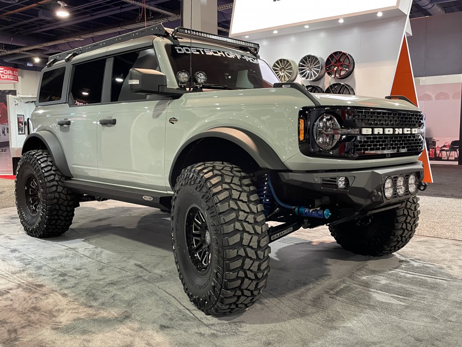

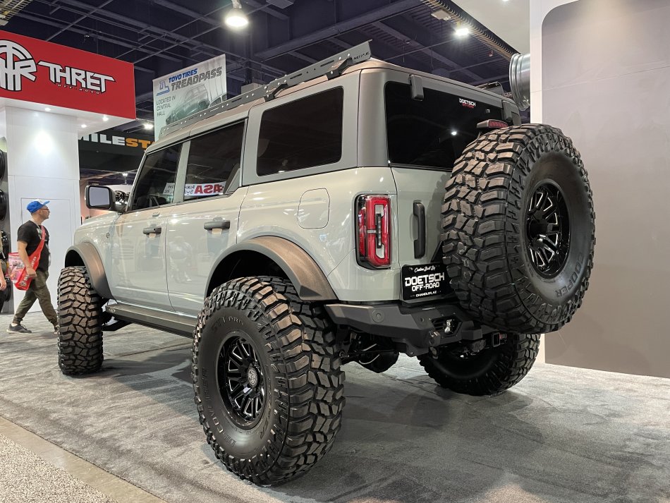

This was one of my favorite non-BRaptors at SEMA. It looked really mean since it was on 40" tires. Turns out that was all for show and they rubbed really bad. They could be made to fit, but would require significant cutting of the crashbar mounts, and some inner fender mods. It looked pretty wicked though! For those of you that want to run a larger tire we should be able to do some perch collars and fit a 39" BFG Mud or All Terrain. Not sure if anyone has tried 38" tires with no suspension mods, but I know a few of you have mentioned you already have the tires ready to mount up when your BRaptor arrives. Keep everyone posted as to how that turns out.

I really like the ADD bumper on the blue BRaptor. Its a huge bumper but looks to fit perfectly to the conture of the bronco.

Yeah, that was a really good looking truck in person. We just did a Wildtrak with the Bomber bumpers, and it looks really sleak since it fits tightly to the contours more, but obviously doesn't hold a winch.

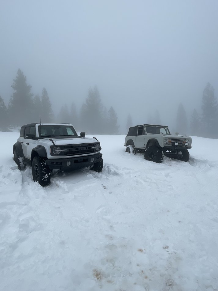

Hi all,
I’m new to the forum and noticed this thread. ADD does bad-ass work on bumpers & accessories. Although I had to mount the front bumper way more securely so it didn’t pull it into the body when using the winch. Basically added 3/8” plates inside the bumpers, with 1/2” grade 8 nuts and bolts. ADD provides weak little 3/8” clips and bolts. Great if you never use the winch or jack the rug up from the bumper. It works good now.
Attached some past and present photos for the hell of it. Fun rigs! Now putting RPG spring collars on to give it a bit more height in the rocks.

Turned out great! Did the front sag much after you put the bumper/winch combo up there?

You know that’s a great thought. I didn’t really notice much. Was more concerned with horsepower loss, and didn’t notice any of that which is cool :).
I don’t think the bumper weighs much if any more. I did ask them this before purchase and they mentioned that they’re pretty close. The stock bumper is amazingly heavy!
Yes the winch adds more for sure, but the freedom when wheeling is worth it.
See attached pics for whether you can tell a difference in rake.
